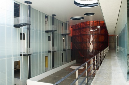

文章陳明城 » 2011 1月 18 (週二) 1:41 am
"Ave Fenix" Fire Station
"The design chosen for the fire station is that of a simple high box that almost disappears after the facade, which plays with the context in a game of reflections..." says bgp arquitectura on "Ave Fenix" Fire Station.
By: at 103 + bgp arquitectura
http://www.architecture-page.com/go/projects/ave-fenix-fire-station__all
在「魚夫寫給喜歡建築和建築界參考的25+建築網站」上瀏覽到,果然功力強大。感恩! :lol:
